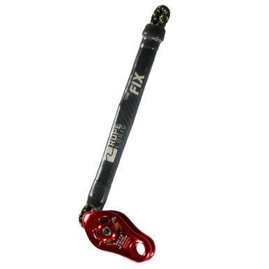

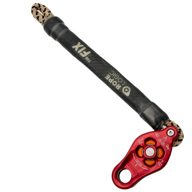

Cory, look at rigging that tether so it doesnt flop with the carabiner. A split tether and a shackle works. Or if you have a very small carabiner. . It is much more efficient if there is no flop in there.
Yup, so go figure, this is a key point:|: I have a stiff tether like the one in #118 on the left with a single eye on each end. So I need a good way to attach the tether to the ZZ. Nothing has worked right yet, the only 2 viable seeming ideas I have are use a biner with a rubber stopper to keep the tether eye from slipping down, or maybe a "Quickie" steel connector (the thing KB invented) to attach tether to ZZ, seems like it would be compact and potentially the ideal compact size.

I don’t own a ZZ so just brainstorming a little while not really in the know.
Why not a locknut and bolt to attach tether to ZZ body? A shoulder bolt and washers or some type of bolt that doesn’t have threads where it’ll contact the ZZ and tether.
Yeah but I'd rather have something that doesn't require wrenches. I just ordered a Quickie, hopefully it'll fit.
My friend, Cory...you are totally missing the boat if you don't at least give the HH1 a try. Add a micro-pulley in for maximum tending, and it is a beautiful thing. If you need pics, there are some from me in here somewhere...let me know, and I'll try to run them down to link, or go back to my personal photo files and see if I can put them up here for you.
Right, wrenchs if you’re gonna take it off and use it for DdRT and SRT. But if that ZZ and RW combo is strictly SRT, then it can get bolted on and stay there semi permanently.
I was just thinking of ways to keep it rigid and reduce flop.
For sure though, get a Quickie and try it, and if you don’t like it, the Quickie has dozens of other uses. Can’t really go wrong.
There’s the Reon Rounds tether too. Looks pretty simple to fabricate, but was expensive to purchase if I remember right. 47B4322F-55E5-4A34-9122-AF70B94D90CA.jpg 39CF9BF7-CFA0-4E3D-9DF5-A4A1AA0DC59A.jpeg DE8FB314-1DDF-40E1-A619-AFC35A9DA75C.jpeg

I rec'd the Quickie by notch, it won't be the solution sought to connect the RW tether to ZZ cuz it is still too large=floppy, but it is a sweet piece of gear, hard to not remove and replace that slick pin over and over and over....

Though I'm barely scratching the surface re SRT, yes I believe you are totally correct re just the right set up. The problem quite simply seems to be my stiff tether- it has an eye on each end but what I need is a single eye on one end and a split eye /or twin eyes/or double eyes on the other end. So I'm going to try to cobble together an added eye for the tether, if it works then great and if it doesn't work, perhaps I'll nevertheless be able to tell if I'm on the right track and then buy a more proper tether
Ok, I just checked it out on the pull up bar.
The jury-rigged split eye thing worked well enough. And then I untied that and got the Quickie to work as the tether attachment point. Think all I need for a sweet set up is the split eye stiff tether with the Quickie
