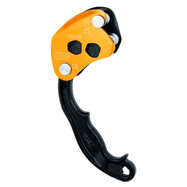

This gent, while a bit wordy, lays it all out plain as day re ZZ/RW/Chicane. I'm stoked to obtain the double eye tether.
