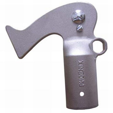

I'm going to clip my down-strand to my harness today, on a cedar prune or 2. It will pull the down-strand away from each cut, easy.
A pole hook with a 'lifter-tip'
Would push that base-tie right up the trunk.

Hummm... well 20200501_105625-1.jpg I also have one of these, if you remember.
I remember.
Yo, that is news to me that you can punch a small biner thru a rope like that?!?
