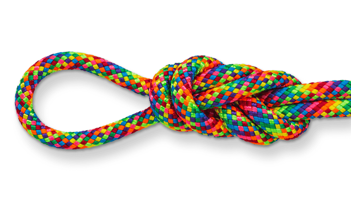

I was window shopping for a prospective new rope to buy the next time I have enough money to spend on one, and I came across one that really piqued my interest. As someone who climbs SRS 80% of the time or more, and as someone who climbs with a mechanical device (Rope Runner Pro) 50% of the time (and a rope wrench for the other 50%), I only buy static kernmantle ropes which have a minimum of 32-strand construction. I only own one 24-strand rope, which I have only ever used as a lanyard (it's only 15' long), and the rest of my ropes are either 32-strand or 48-strand kernmantle.
I ventured into some obscure online rope vending websites, and visited a variety of different arborist supply stores that I had previously never heard of, and found this really cool looking, 32-strand kernmantle rope with a Nylon core that is currently available for presale purchase. It's made by Atlantic Braids and it's called the Endurance Aya, and it was designed specifically for SRS climbing.
Has anyone ever heard of Atlantic Braids? I'm hesitant to buy a rope from a manufacturer I've never even heard of, but it looks so awesome. It's a little over $1/foot.
I also came across a really awesome 24-strand rope that I wouldn't mind buying with a spliced eye on one end and using strictly for MRS. This one is made by a well-known manufacturer, Yale Cordage, and it is called the Blue Tongue. This has to be one of the coolest looking rope patterns I've ever seen. It's hard to find vendors that sell this rope, and I believe the one linked below is located in the UK. The pricing is really fair for a quality rope that comes with a spliced eye on one end, but the shipping is costly, but not obscene.
Anyways, I hope I come into some money sometime soon. I need a new rope, but I also need a new rope with a spliced eye on one end because all of my ropes right now have sewn eyes, and that makes using them with friction savers, pulley savers, and with MRS climbing systems like the Hitch Climber setup less than ideal and difficult.
The Endurance is cool looking. I know of AtlanticBraids, but haven't used their rope. I think they have a good reputation. They just aren't one of the big dogs in North American ropes. If I saw something from them I really liked, I wouldn't have a problem buying from them.
