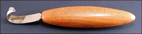

i use a hatchet, a small carving knife, gouge, and a hook knife. i made the knives, they are in my shop, but ill get some pics. these are similar.

i dont do spoons much any more (im hooked on the lathe currently;)), but when i did i always used green wood. limb wood, split, then roughed out with a hatchet, carve the outside and handle, then used gouge and mallet to rough out the bowl, hook knife to fine tune. dry slow in a plastic bag (turn the bag inside out every so often), then sand and oil. there is an excellent little article on the back page of an old fine woodworking mag that describes perfectly the process i use. sorry but i don't remember the issue, but it was back before they were in color. ill try to find a copy or link.
