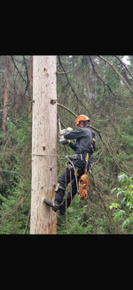

I climbed this nearly dead madrona to 70' yesterday at 4pm. Took one squishy step and was still having 25-30' of spreading, basically dead top above, so I threw a throw line into an adjacent doug-fir about 25-30' away.
Today, was a Wraptor ride, then climb to about 130' to 4" wood, transfer to a neighboring maple to clear conflicting limbs, then a break and spurs on.
I hope not to want the high TIP in the adjacent fir. Even more, wanted to not need to climb another much taller and farther fir fir a V-hang or high line.
Slow and deliberate, always ready to call it off, finally got the the small, solo negative rigging done, making a wobblier endeavor for a few chunks, then less wobbly and some overhead rope-support as the spar shrank in height, grew thicker, and got closer to the support tree.
