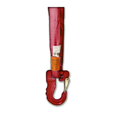

This is the heavy version of that hook. I tried finding the gunnebo version but didn’t come across a price or US distributor. Prolly didn’t look hard enough. I know you have to be alert to install them properly or you can load the gate. I’d like to try them

I used to be comfortable using chains with gates like that. One day the climber set the chain and I swung him over to his cut so he didn’t have to traverse. Went back over the chain and tensioned up to what I guessed it would be. He cut it and the limb rolled a little bit then dropped. We have no idea how it managed to do it but it did. When lifting picks over peoples heads I want to be certain they don’t come undone
I certainly can't argue with that.
As I hooked up the first pic, the op pointed out that I didn't have the hook correctly hooked- it needs to be hooked so the spine takes all the weight once the pick is made and hanging free. If hooked the opposite way, the gate could coceivably take some of the weight. It is an easy thing to check for. As I am the guy up there, I feel ok with it.
