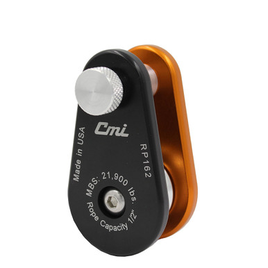

How about this block? Since the other guy is on the big side
... it all depends , you can do tons of work (pun intentional) with that 1/2 beauty ... just don't over the shit out of it or the line. Actual guesstimate on weight plus any potential shock load. Truth is , to me blocks were stepping it up from natural crotch lowering

I don't think the other one is on the big side, i use the un-galvanized version of it exclusively. Affordable, large bend radius, and built to last; what more do you want? 2 tons wll on a pulley is only 1 ton on the line, which is what you are looking at negative blocking 500 pound chunks to help put that in perspective. I also am a huge fan of natty crotch, in illinois I'm usually in hardwoods so i don't see the reason to complicate the issue. I get using a pulley for lowering dozens of small sappy limbs from the same rigging point so the line isn't trashed but on hardwood you don't have that problem. Tossing a line over a crotch or a quick half hitch is all i need to start rigging, so I only use pulleys when I need to lift something or am rigging large enough that natural crotch is going to start damaging rope.

i ending up going with the cmi 2 ton pulley, i thought about it and remembered that i bought a 5/8 inch rigging line. i liked what you said tree09 it made a lot of sense and you are part of the reason i went with that block. the only issue with natty rigging is that some of our trees have thin bark actually most the trees i prune have thin bark out here.

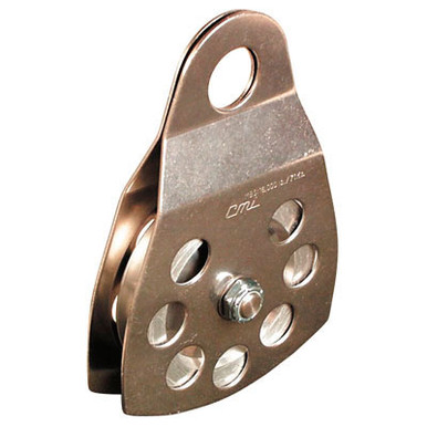

i also like this pulley
but they make a stainless version

I'm in peoria, who's your family? Its a smaller world than you would think! Good luck on the pulley, I'm sure it will serve you well for years to come. I also have the ss version of the pulley you showed, very nice but with the thinner side plates i wouldn't block with it. Fiddle blocks work fine, it's just slower and doesn't have progress capture so lifting can get sketchy if you aren't careful. You can also use a truck or machine to do the pulling for you if one's close enough. I use 1/2 for the light stuff and then 5/8 treemaster as i get in the bigger stuff. The 1/2 works well on my homemade grcs winch thing, so I use that for lifting duties for now. I'll also use come alongs or chain falls as needed, that's how i usually pull trees by hand.
