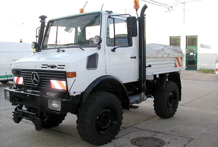

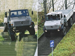

ha, found a decent pic for comparison sake, a Unimog 404 vs a smaller rig (G unit)...

OFF topic but the unimog with a southco body would be a choice rig. Little bit too much money for the treeman though. Course you would definetly have your advertising gimmic.
pinzgaur! lighter than a unimog, but the same or better off road capabilities. Just not the same capacities
