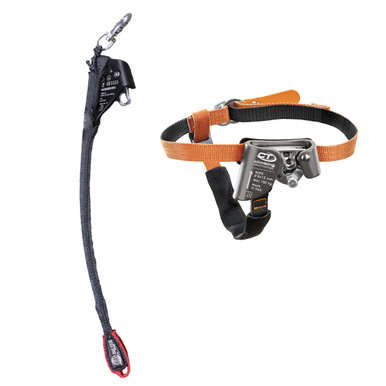

Are there other jet step fans here? The reviews look good.
I would go ct, and get the holder for your spurs too. That way you only need 1 ascender and can use it on your spurs.
I will have a CT soon...I ordered this from TreeStuff Nov. 24...en route now:
1 ea. Climbing Technology Foot Ascender - Right Foot
4 ea. Notch V3 Quickie

Drum roll, please: I ordered the HAAS velox with foot strap and the CT right foot ascender. Also the Notch Quick step cuz it seems like a good one and is ambidextrous which could come in handy if my balky knee wants to change things up. Thanks for all your input
I think you are gonna be liking the SRT. It is SO fast on free ascents compared to DDRT. It has taken me a long time to start making it feel doable...several false starts but learned a bit each time...and starting to use SRT as my go to now.
I looked at the Notch Quick step, too...I watched Nick Bonner's video of comparing them...The QS caught my attention, too. That Velox looks good.

i use the jetstep. because it is ambidextrous and i like to be able to kick out. prefer not to have to fiddle with it to get out of it. i footlock a lot though too. still after all is said and done, its the simplest way for me to get around a tree although slightlyyou have to watch out with the jet step on the right foot walking on the ground as the fairlead can catch a pant leg or shoe lace and drop you.
