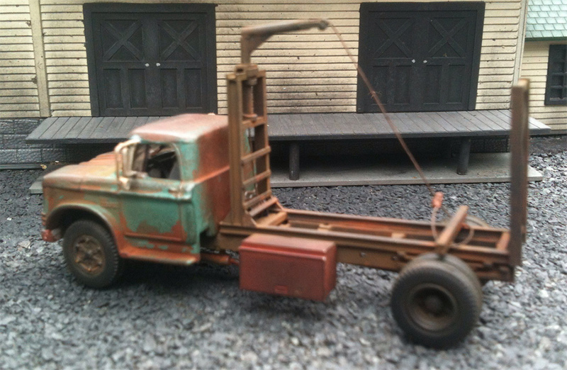

Here it is, better late than never lol. Needless to say i need to do some clearing in the back 40 when i get some time. And the truck is for sale, cheap, so i should probably pull that crane off before i sell it and put it on a trailer. I'm telling you, with an atv winch to act as a hoist line, it actually does pretty good. I did tie it into the frame to make it strong enough, and on a half ton you beat the crap out of the leaf springs :\: I only adjusted the boom angle with no load, depending on where in the truck i wanted to put the logs, so really you don't even need a hydraulic jack for that. With the tailgate off, i would simply swing the boom out the back, set tongs or a choker, hoist (about 8 seconds to fully lift at most), swing it in the bed, lower, then unhook and pull the choker out.
