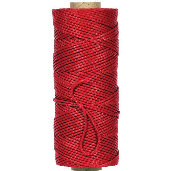

I bought some of this to try and like it. I was interested in that it came in a 425 foot spool at 1.9mm. The two I purchased have performed well. I ran them across a bollard to remove the spool memory as I flaked into the cube. Hardly a snarl after that. Has a nice hand. Bleeds a little dye. No biggie.
I need longer hanks for isolating shots at times. Or throwing out from a tree top to retrive a pull line instead of throwing a bag of pull line from over 100 feet.
Capillary throw line by ECW from WesSpur. Nice value. :thumbup:
  • #62
Certainly a good price. Maybe I'll throw some in my next order, and check it out. I still have to try the ZingIt I bought.
