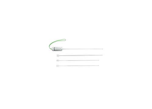

I got a very nice wire fid from Ronstan D-Splicer in Holland. They have three sizes all designed for very small hollow braids especially dyneema.
You can buy the three sizes with plastic handle or get a kit with an aluminum handle that fits the three “needles”
