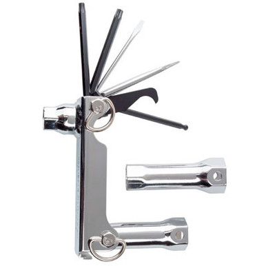

Is the allen wrench standard chainsaw size(whatever that is)? I ask, because I have that TopSaw multitool. It's utility is a little dubious, but if the allen wrench fit The RopeRunner, it would add to it's value including it on the saddle.

It is 5mm
TreeStuff says the ball allen on the TopSaw is 4mm, so not useful for the RopeRunner.
