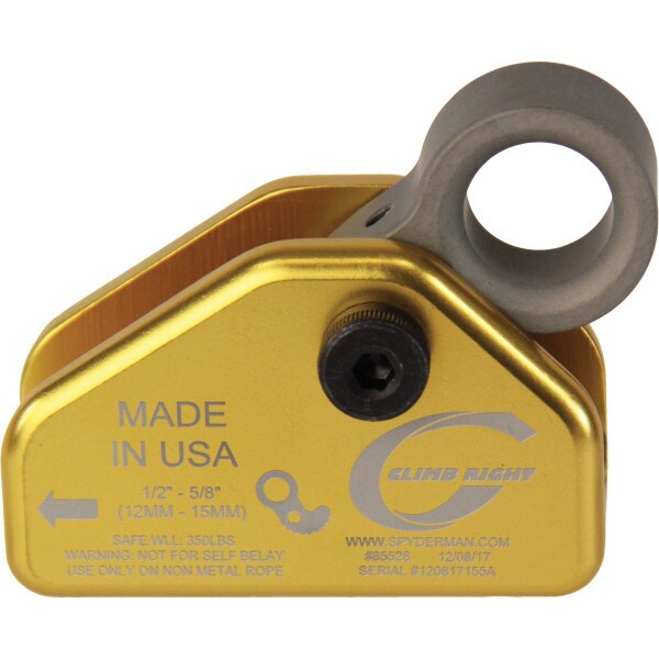

Never much cared for a prussic for capture. I prefer a rope grab as there is less set back.
I have one of these for cature. They have gone up in price since I bought. But takes up to 5/8ths rope. Which does come in handy on certain applications.
