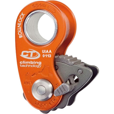

I have a Rollclip Z triact for the SCAM retrievable redirect but this is different. The rope grabbing component on the Roll-n-Lock can be locked open, so it can be set on the rope and just follow you down a limb. Lock it in place and give it a flick and it will slide up the line allowing you to use a 3:1 without using tons of extra rope.
The only caveat is that it can slip on some ropes if not set by hand first. Still, a really useful tool.
