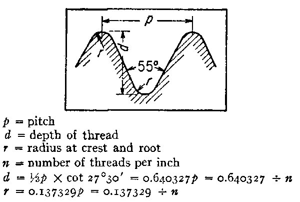

If it is Withworth (BSW) you mean it was very common here. In fact Husqvarna used it on most products up to they started chainsaw manufacturing. They used BSW threads on first saw they series produced, MS90. After the first Model/version of ms90's production was out they dropped BSW completely.
You could think they choose something to call standard and stuck with it, but no...
It still was mixed MM, UNF, UNC, BSPT,
I can't find anything on Wentworth threads.
Most Brittish MC (and Swedish) used Whitworth up to early 60's.
I wrenced a bit on old Nortons a long time ago...
