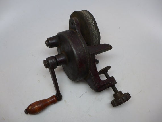

What kinda hand-cranked grinder do you have?
I'm at mom's, and don't have a pic on my phone, but it looks like this...
I drive a splitting wedge into my oak log, then clamp it to that.
