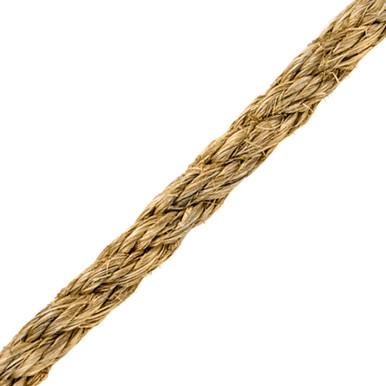

Even half inch manila rope set against itself with a taught line hitch. the friction during a descent can be dialed in precisely by how you set the knot first, and second how you squeeze it and allow tension from the bridge to bear on the knot during the descent. Old school, but still sweet.
Tubb's brand, arborist grade 3 strand half inch twisted manila rope. It would last a good climber 6 months to a year. Depending on how much you climbed.
Synthetics started coming in use in the early1970s. Changed everything.
Might be fun to buy a short length of manila and do an old school climb on it. <50¢/ft
@gf beranek Thank you! Also, great insights as always. I'd be curious to see how that three strand rope performs. I can't imagine what life would be like without polyester and nylon and aramid fibers.
@lxskllr You're way ahead of me. That's an awesome idea. It would make for unique content as well. I've never seen anyone else do something like that. I'd need enough for an MRS setup and then I could just cut maybe six feet off of the end to make a split tail. Fifty feet would probably be plenty. Definitely considering doing this. Sounds like a lot of fun. Maybe give me a new appreciation for the cordage we have now! =-D
When the synthetics come on the scene the first obvious problem was fusing / melting, getting locked up on the line. WTF?
Understand, in the spirit of competition we use to race to the ground. Smoking the ropes, quite literally, which wasn't a problem with manila.
So, to solve that problem I started using a manila tail to from the hitch against the synthetic. Problem solved!
Another thing is we fashioned the friction hitch using the tail end of the rope itself, which progressively shortened a manila rope about 3 to 4 feet every time we wore out the hitch. Get pretty thin (scary)
If you climbed a lot, we climbed everyday, a manila rope would wear faster on the snap end. It would get smaller in diameter. The tail end would remain fat. So periodically we had to reverse the rope to even the wear on it.
Little things. lots of little things with manila rope.

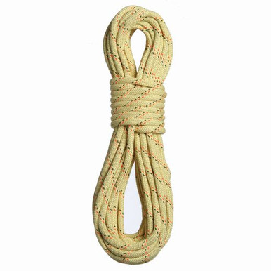

Why is Sterling RIT (my favorite hitch cord) over $8/foot at Treestuff, twice the amount of their second most expensive hitchcord, when I just got it for $2.32/foot at Wesspur?
Wesspur also has the deep blue colored 9.3mm Epicord right now as you see in my previous post's images.
Not an advertisement. Just wondering what's going on with Treestuff. Why the egregious price hike on such an epic cord (not to be confused with EpiCord! Ha, look, I made a joke!).
