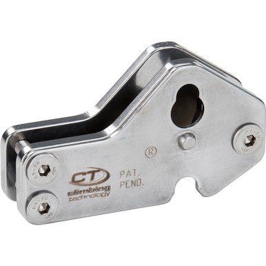

I’d like to figure out a solid design to make my own spur mounted ascender for Bashlin aluminums and Buck Titanium. Preferably without drilling into the climber.
I was browsing treestuff and ran across this...
Might give you some ideas.
