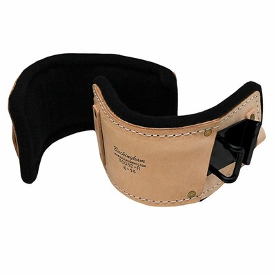

Found a picture. They are designed to ride similar to the Caddy pads but they are smaller and more comfortable IMO. Notice how the mounting bracket is angled so they are not reversible, you must have them on the correct side to wear them.
Opsal is an old manufacturer of the generic "caddie pad". I have a set on my Bashlins. I don't know the reason for the rotating issue you are experiencing, wish I could help.
Hmm. That's the kind I have(Buckinghams above), and I've had zero twisting.
