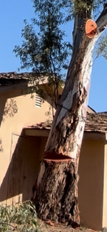

I used my narrow Muller alum wedge vertically into the side of the gap face (tension side) here, hoping to save time popping the whole face out at once. Unfortunately, I got a jagged one third and had to fiddle around with saw and axe considerably, edited out of video. Maybe I will post the long form…
