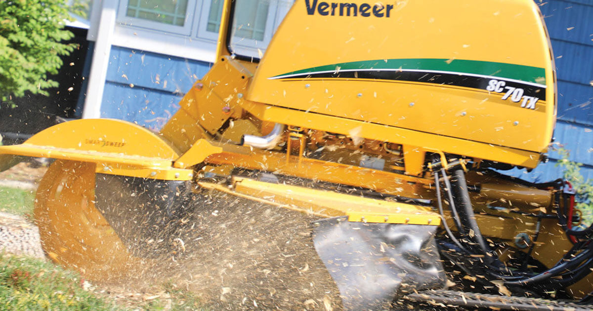

What kind of HP on the RC ?
I think the vermeer ones are 60-70hp
67hp. The one I used I think was a SC60 and from what I heard it went through U-joints or gear boxes kinda fast, so I hope they fixed that.
