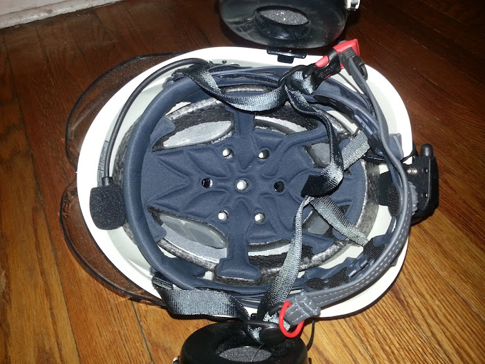

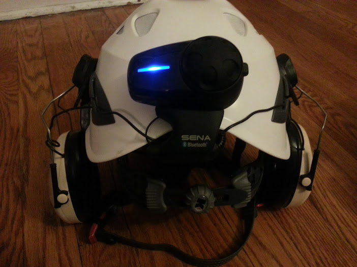

Today was the first day running the helmet intercom system from RopeTek. Paul custom installs high end Sena intercom units into Kask Super Plasma arborist helmets. This is a full turnkey conversion. The speakers are built into quality, low profile 3m muffs and the boom mike is built into the helmet. In all but the noisiest environments, we found so far that you can run with mike tucked up in the brow of the helmet suspension (3rd picture) and not have conversation suffer.
The noise cancellation is awesome. You can definitely tell that a log chipper or a chainsaw is running, but you can hear them talking over it easily. We were all amazed that one guy could be chipping and talking to someone else running a saw 100 yards away, like they were next to them in a quiet environment.
After about 10 minutes I already took it for granted. I listened to 3 albums today, and told a about 500 jokes, all while working. I asked for some tools too, without yelling. Its gonna be hard to put these down!

Time will tell regarding durability and battery life, but they lasted all day today and seem well built. The box includes chargers, audio cords, extra wiring, and speaker/microphone hardware.
Bonner for best results position the mike as close as possible to your mouth and obviously make sure it is oriented correctly so the noise cancelation doesnt cancel out your voice;)

Nick, it helps to run the wires from the speakers straight up into the helmet so there is as little wire exposed as possible. Also, make sure you use a strong adhesive for the speakers and mic.
  • #8
The speakers are hidden in the muffs, I dont know about the adhesive there? I have the mic held up with a zip tie and two tiny holes in the helmet.
Paul, you are right, having the mic close to your face gets the best results. I was just saying that we were surprised that it still worked with the mic tucked way up in the brow of the helmet.
Al, I can try and find the weight of the Sena usits, but its really inconsequential compared to the helmet itself (Kasks are a heavier helmet already).
