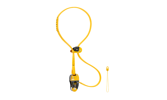

New Petzl Tool
If only, around 10 years ago or more, someone would have devised an SRT device to work in this situation. 🐒
