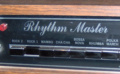

aye,
rock1 and rock2 were two setting on an old drum machine i got when i was a wee lad
eg
its just what pops out when i log into a site.
can't be helped
