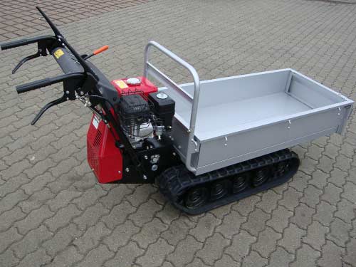

I've climbed some pretty steep grades with my Muck Truck in 1st gear with about 800 lbs on.
Not sure I have done 38% inclines like the Muck Truck website claims it can do. But by off centering the load ahead to compensate for the incline I done a lot of steep terrain work with that little machine.
I just revisited that website and it's 38 degrees not 38% incline the machine is capable of climbing fully loaded........ so that would be about 78% grade.

I think in the case of my Muck Truck with a 4 inch wheel base and the operator walking behind, the limit of approach and the 4 tires footprint are at the maxium for climbing stairs, rough ground and 78% (38 degree) inclines with a full 800 lb load.
A tracked machine would just slide back down a flight of stairs. Same thing I'd think on very rough slopes.
As this video shows. Notice the loose gravel laying on the steps doesn't effect the Muck Trucks traction.

Yes in my barrow's wheel base measurement ...4 inches between front and rear tires.
Looked like sorta optimum tread length. That was great climbing.
I wonder how a tracked machine would work on stairs.
A tracked machine would slide backwards down the stairs, especially if it had a full 800 lb load of gravel on it like that Muck Truck was carrying.
Ok Sean I see the confusion. To add to my last post the true wheel base of my Muck Truck is 22 1/2 " inches between the points where the front and rear tires touch the ground.
