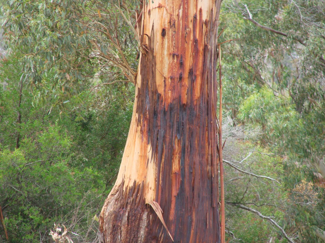

I know I'm half a planet away, but we are seeing a phenomenon of what the boffins think is air embolism in severely drought stressed trees. It's been nicknamed 'ginger syndrome' the gum trees start to leak kino all over and they take on a ginger colour then die.
Discolouration under the bark in your tree would indicate to me something wrong with the transport system, whether causal or resultant...who knows?
