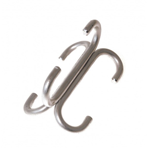

A New Tribe grapnel is a very specialty tool that van be used for rope advancement.
Not sure if that's available anymore. Stig sent one, and while it isn't frequently used, when I need it, it's super handy. This might be the closest replacement for the grapnel...
