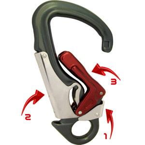

I am a big fan of ISC's snap and also their carabiners.
I have three of these; the one on the lanyard I use the most gets bent and the side plates of the 1st latch bind under the side plates of the 2nd latch, rendering it 'locked open'.
Not fun. Even after realigning the plates they are stuck again within a tree or two and those extra few seconds to free it and check it add up. Seems the plate thickness is too thin.
Can you disable the #1 latch on that clip? Looks like it could be a useful item without the extra latch to get hung up.

I like the ISC triple snap (whatever its called). I got one shortly after they came out and now it is instinctual to me. I haven't had probs with the bent plates like Pat is talking about, so I'm gonna keep my fingers crossed!
Skwerl, the #1 action for that snap was put on to make it a triple action snap, because the double action snap had a tendency to roll out and open up very easily when pressed against something, which often happens to a lanyard snap. Made for a few scary scenes for a few guys if I recall. That snap led to the ban on all snaps by the Euro TCC for lanyards.
I have been using the ISC triple action snaps for several weeks now. Not long enough to speak for their longevity and durability, but very smooth and easy to use. I did notice today that fine sawdust had filled the gap on the smallest 'action' and had to be blown out to move properly. Before I used the petzl am'd ball lock. I prefer ball lock over push/pull, just easier for me...
