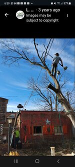

To be clear, how do you all read the weight distribution of That tree?
Not
How does one read the weight distributing of A tree?
Not
It’s hard to say not being there. At first glance it looked like it had head lean with the limbs closer to the road, but you only have one angle view point. The trunk could have had more back lean than shown. Obviously enough to break that pull line before the COG came ahead to the lay.
I don't know the lean.
I see a potential for a strong back leaner or a reasonable neutral or front leaner. Probably not a front leaner (bet money).
Any rope breaking and tree rocking back could cause failure. If they had a bad spot or a knot, it could be easy to break a rope.
We broke a 34000 pound amsteel line trying to pull a tipped tree away from a septic treatment plant on an island pulling with a very small dozer. Remote install with a RB. Limited resources.
My supervisor didn't like climbing if avoidable, as he felt in the hook for a rescue if something went wrong and only one subordinate brute me was a good climber. Maybe we didn't have our climbing gear with us. Woulda been an easy tensionless hitch or basket-rig if another tree was climbed.
Zing!
The tree stayed put.
People rely on one rope a lot where 2 would be prudent.
Is the big bucket truck pulling the medium truck?
Anyone zoom in on the knot/ mess?
Looks like they could have improved their rope angle and rope height.
