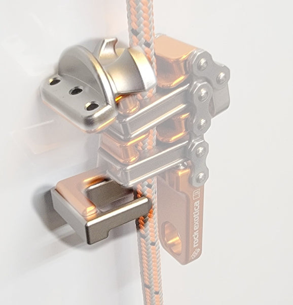

Thanks guys! The Mumford add on is something I’m interested in and will pull the trigger shortly. I’ve seen someone put a wheel on the bottom of their Unicender to tend it like a hitch climber. Seems to be a great modification.
I’ll deal with the additional wear and tear rather than give up the mechanicals. I just really love the compact nature and zero sit back of the Unicender and Akimbo. Also, I don’t sew or splice at the moment. Watched a few tutorials last night on splicing just to get an idea of how it’s done and what I’m climbing on. That seems like a good skill to learn but I’m still very deficient in many skills directly associated with tree care so it’s down there on the list.
