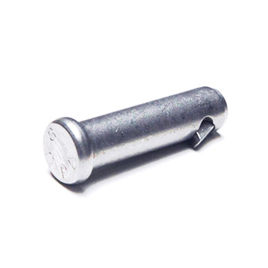

Is the rope wrench slic pin different than the notch quickie slic pin?
Where did you get your slic pen?
Yup, very different pins. I believe the pin diameter is different, the pin length is definitely different, the Quickie is for primary life support, so it has 2 separate cotters. The Rope Wrench has just 1 cotter. The Wrench is a part of a life support system, but when used properly, if it was to fail, it wouldn’t drop you, you just wouldn’t be able to descend. The Wrench just takes a bunch of friction away from the hitch. The Rope Runner has double cotters too, if a pin fails on that, the climber falls.
Fun fact; I thought “ Slic pin” was just a neat name, but turns out it stands for “ Self Locking Internal Cotter”
Oh by the way, I got 40 or so single cotter Slic Pins that I got from a site’s clearance section, so no returns. They’re too skinny for the wrench, I can check the actual diameter and length. I’ve no idea what I could ever need them for now, so if anyone wants a couple, let me know.
I got a (1/4” I think) D shackle that they fit with, and I think they’ll still fit fine if I drill the threads out of the shackle… still not very useful though. Single cotter means not for life support, and the shackle is too small to bother using it for any rigging application.

If you could please post the width and length of the slic pins that help determine if they will work when ever is convenient that would be fantastic.
I knew I should have bought two pulleys from cmi last week. Fortunately they have free shipping with no minimum. I have really benefited from their cosmetic seconds the past couple of months.
That’s right, forgot I sent a couple of those to you. Was having trouble finding my caliper, but they look to match up with 5/16” bolts.
So these pins aren’t going to work for any device or connector available on the market, but if you’re building a wrench from scratch, you could make the hole 5/16”.
