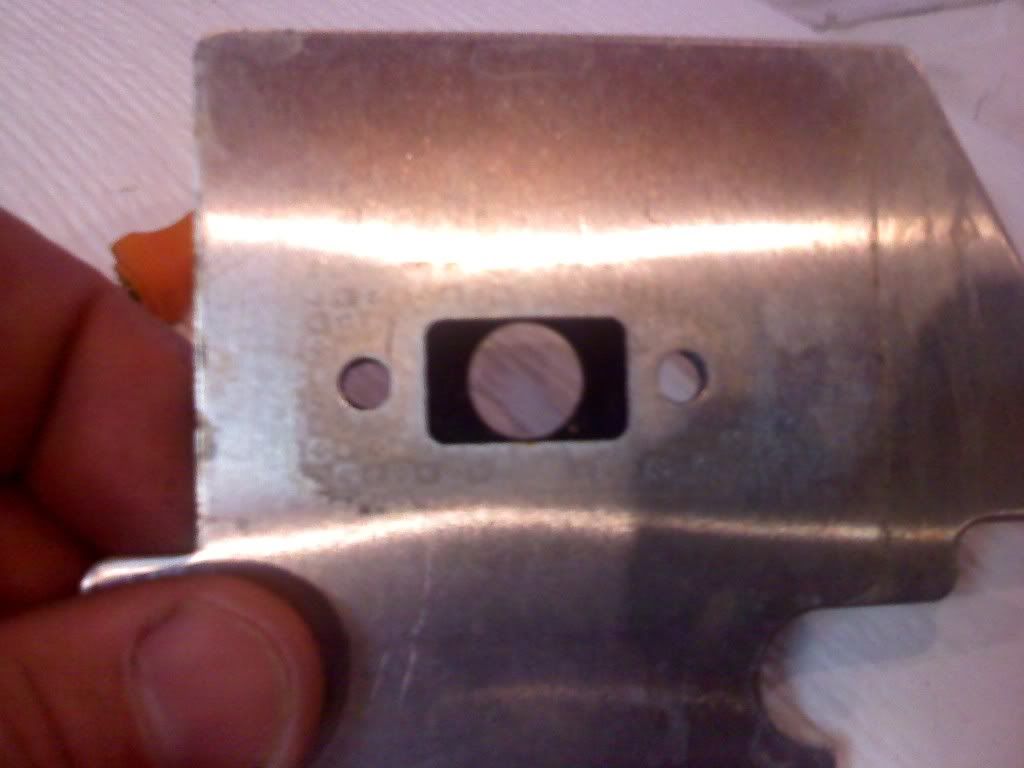

Here's a 2010 redmax 2650 that has run from april to about the 1st week of august on ultra.
I was alittle disappointed reading all the internet talk of how well synthetic oil is.
But this may have contributed to the issue.
It didnt go back together that way.
