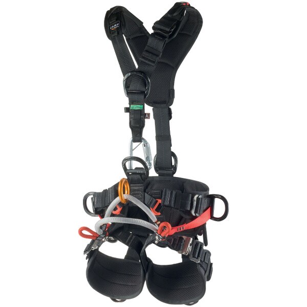

Thinking about saddle upgrades in the next few months. Thought: If you’re going to use a standard saddle with suspenders, why not have a full body harness? I don’t see a lot of guys using full body. What are the reasons? Cumbersome or restrictive? Weight?
You must know about a harness of which I'm not aware. The only full body harness I know of is a 'fall arrest' harness with the D ring in the back. They are OSHA required for aerial lifts but I refused to wear one. If you do fall out, you are completely helpless to rescue yourself and are 100% reliant on somebody else getting you down. With a 'work positioning' harness that has the attachment point in front, you have the ability to rescue yourself. Of course none of this has anything to do with climbing trees.
As you gain experience and get older, you will discover weight of your gear is an issue. Young teens can handle the extra weight but those days will be fleeting. Supportive but lower weight is the priority for most climbers. A full body harness seems like a trip in the wrong direction.
My understanding is that if a work positioning were to catch your fall, there's a good chance of a broken back or other severe injury due to the front attachment point
I have a cut down version of this as my truck setup...
Mine doesn't have the rope bridge. It's not bad to wear, and not particularly heavy, but I don't care for stuff over my shoulders. I needed fall protection for work, and this allows me to get in trees with it too, but I prefer a regular saddle. If I needed suspenders anyway for whatever reason, might as well get suspenders that can hold you up if necessary.

I was thinking something along these lines. Sold through arb supplier. Would never use the back d ring though. Would hold you in of upside down I guess.

That’s the stuff I’m looking at. Got a D in the center? I like suspenders and will start clipping extra biners to them once I get my climbing configuration sorted. Can I try yours please? I’ll let you play with the Unicender!
DBA Selwa(?) Exofit brand makes some full body work positioning fall arrest harnesses for tower and rope access work.
My fall arrest harness that I use in the lift is an Exofit crossover meaning it can be use as either fall arrest or work positioning.
That all being said it’s hard to beat a true tree saddle.
Some of Buckingham's higher end saddles have addon fall arrest available. It could be removed for circumstances where you didn't want it. That's a negative in some construction environments. Some groups don't like removable fall arrest, but that wouldn't affect you.
realtime edit:
Sure, you can try mine any time. It's the one I wore last time over. It has two work positioning Ds on the sides, one you can climb on on the lower front, fall arrest top front and top back, and work positioning lower back. No rope bridge.
up in the Nifty Lift, I always use a full fall arrest harness with the back D-ring. I'd rather be hanging and waiting for someone to lower me than lying on the ground waiting for an ambulance. I tried using a saddle with the fall arrest attached in front but it just gets in the way.
I'm very much new in this industry but am a bit of a gear/book head. if your looking for a new harness you could always go with the tree motion evo. The back "dee" ring is rated for fall arrest while you would still have your climbing bridges. Add some suspenders ( I have the camp tree access srt and I love it, I know: not osha/ansi) and just remove them when you don't need them. Just an idea if you fell on a harness with the rear dee attached could you have a hand ascender to reach back and pull yourself around to attach your floating dee and work your way back to the bucket? last idea, if your using the front floating ring as bucket fall arrest and worried about the shock load. Would incorporating a shock absorbing tool like a petzl absorbica be a safer solution? Again just a new guy that is passionate with ideas. Please correct/educate me in any way you see

I don't know much, but I don't like the idea of falling into a centrally mounted(on body) anchor. Seems to me your body would tend to fold around that point in a fall, and the results could be painful-disastrous. Maybe better than hitting the ground, but for fall arrest, I think a top mounted anchor is much better/safer.
  • #13
Nice to meet you TinyHulk! Thanks for your feedback. I’ve heard good things about the Evo. It’ll probably be a “try on and see” situation at the local arb supplier. There are shock absorbing lanyards for fall arrest. I’m mostly thinking about the full body for the support and not tying off to the back D. I agree that being caught by that thing would cause a real bad day. Even when I rec climb I wear suspenders. It just feels better to me- all cozy and stuff!
