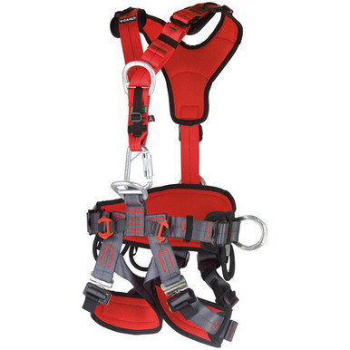

I've been looking at different fall arrest harnesses, seeing if something interests me enough to change over from my HomeDepot special. It's the basic nylon web harness, where putting it on is like trying to organize an octopus. It serves it's purpose, and since it isn't something I regularly wear, sufficient I guess. I also have self rescue in mind in case of a fall, and that's virtually impossible with a basic harness. TreeStuff has this...
Y'all think that would be ok to occasionally climb in? There's been a couple times my climbing gear would have been handy, but it was at home. I could keep the above in the truck with a length of rope, some cord and a couple biners and handle the occasional little thing that pops up. I'm just thinking at this point. I'm not sure I want to drop $300 for a harness I'm not using every day, but it is a lot nicer than what I have, and could be more generally useful, even if it isn't used a lot.
We used several styles like that on Ski Patrol to climb lift towers without any problems, their main design is for fall arrest but with ropes and mebbee some webbing and hardwares they can be used for work positioning as well as long as there are some dees.
I like the looks of that harness. Lots of good D's there...2 in the back is interesting. My first gander says it is a good idea.

Yea, I thought it looked pretty credible. If I was gonna make a big purchase for work, now would be a good time for it. I've got at least four bridges to do in the next couple years, so it would get used. Still a lot of money though. I've gotta think on it, and figure out how good the value is to me...

I I have a harness similar to what you are considering. As an industrial electrician I am frequently required to have fall protection. I like this rig better than conventional fall arrest only harness because it gives me more options for work positioning lanyard and even ascending or descending on rope although I save that for unusual situations. On my jobs I am the only one I know who works like this. Usually we try to stay in the basket and not monkey around out on beams. When I need to leave my lift, I am trying to use the work positioning lanyard more often as an adjunct to 100% tie off with fall arrest lanyards. I like the sense of security and having my hands free to work. AC0BE138-ED12-412D-A78A-CBD35F51A3F2.jpeg
