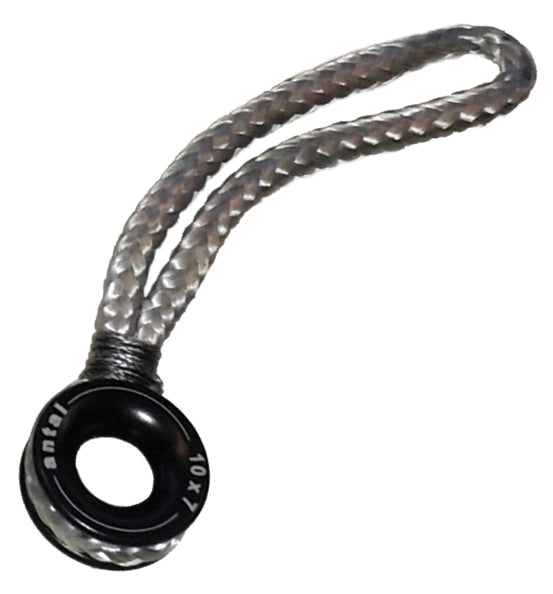

You could splice a grommet for it or similar and then attach it to the ultra sling. You could have a small hook/shackle/other attachment method on the ultra sling, and then just clip the loop holding the thimble thing. There's even ways to do it all with single braid, using soft shackle knots and splices.

Derrick, your creativity makes it hard to understand your ideas. I did think about the soft shackle. Never seen anyone use them in tree work so I didn’t know how strong/safe they were for our work

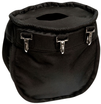

Very nice, my first day with the new company they had me in a huge oak tree and the rigging line they sent up was the most glazed and hard true blue line I’ve ever seen. Was almost scared to rig with it, dropped some 800lb pieces of oak with it and it held up. We have a different rope now that I have us use for rigging. Boss likes me to use rigging anchors to refrain from burning up the rope. I always have a company block or ring on an ultrasling with me so it’s pretty simple, need to find a better gear bag to keep on my harness. Been looking at the one from weaver with the stretch top. Reminds me of a magazine dump pouch
