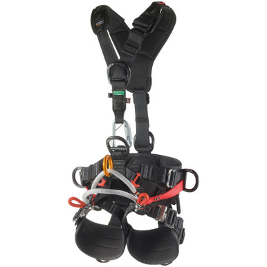

It's not the TreeAccess, It's the ANSI XT. It's basically the TreeAccess minus the rope bridge. You can connect the climbline to the lower D, and you have the work positioning stuff of normal saddles. When I got it, I wasn't aware of the TreeAccess, but I probably wouldn't have gotten it anyway. The one I got was for fall arrest for work, and as a minimally functioning saddle I could climb in while at work, while my main gear wasn't available. And of course the cheap price. I paid about $255 for the ANSI XT after TreeStuff coupon.

I've been looking at different fall arrest harnesses, seeing if something interests me enough to change over from my HomeDepot special. It's the basic nylon web harness, where putting it on is like trying to organize an octopus. It serves it's purpose, and since it isn't something I regularly wear, sufficient I guess. I also have self rescue in mind in case of a fall, and that's virtually impossible with a basic harness. TreeStuff has this...
